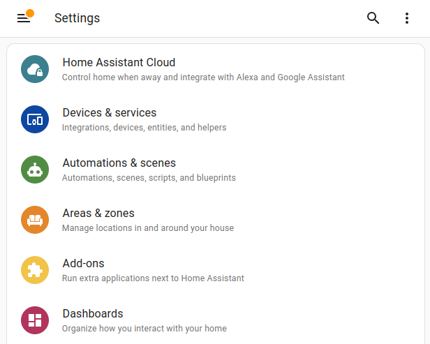

  1. Log in to the Home Assistant web interface and open the Settings section.
    HA settings

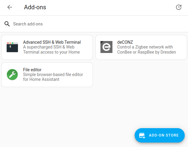

  2. Open the settings of System and switch to Add-ons.
    HA Add-ons

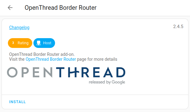

  3. Search for Open Thread Boarder Router in the Add-ons store and install it.
    HA OTBR Add-on install

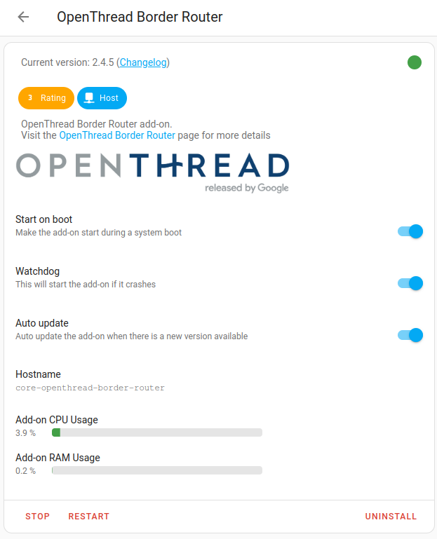

  4. Configure the Open Thread Boarder Router add-on.
    HA OTBR Add-on configure

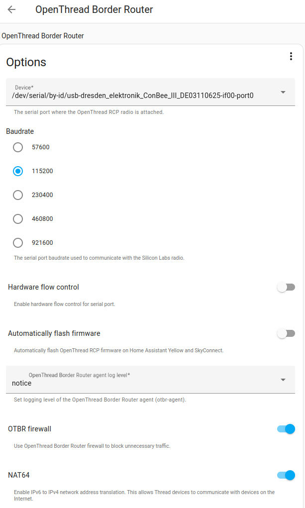

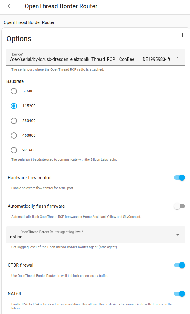

  5. Depending on the used Open Thread Border Router a different setting of the Hardware FLow Control is necessary:
    • ConBee II: Hardware Flow Control = enabled
      HA OTBR Add-on Konfigurieren ConBee2
    • ConBee III: Hardware Flow Control = off
      HA OTBR Add-on Konfigurieren ConBee3

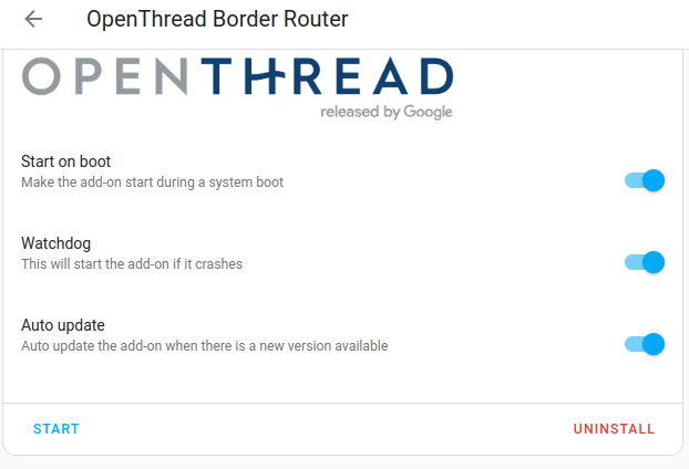

  6. Start the Open Thread Boarder Router add-on.
    HA OTBR Add-on start

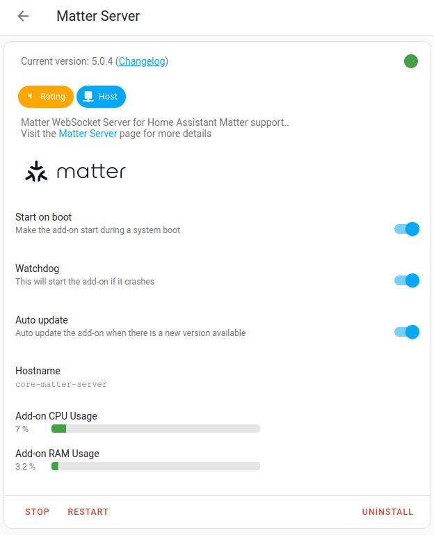

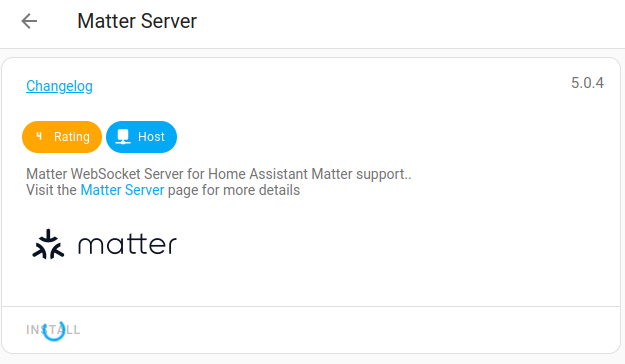

  7. Search for Matter Server in the Add-ons store and install it.
    HA Matter Server Add-on install
  8. Start the Matter Server add-on.
    HA Matter Server Add-on start

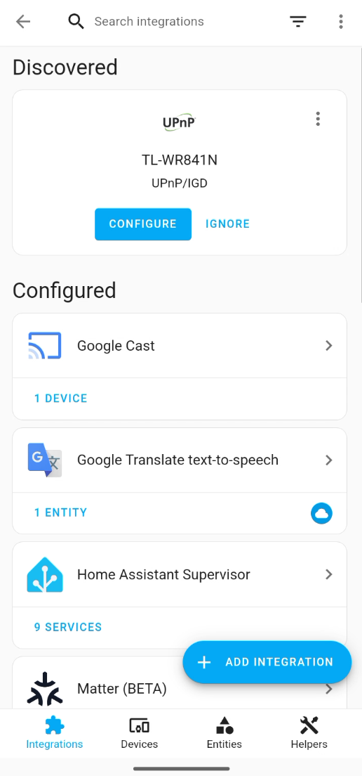

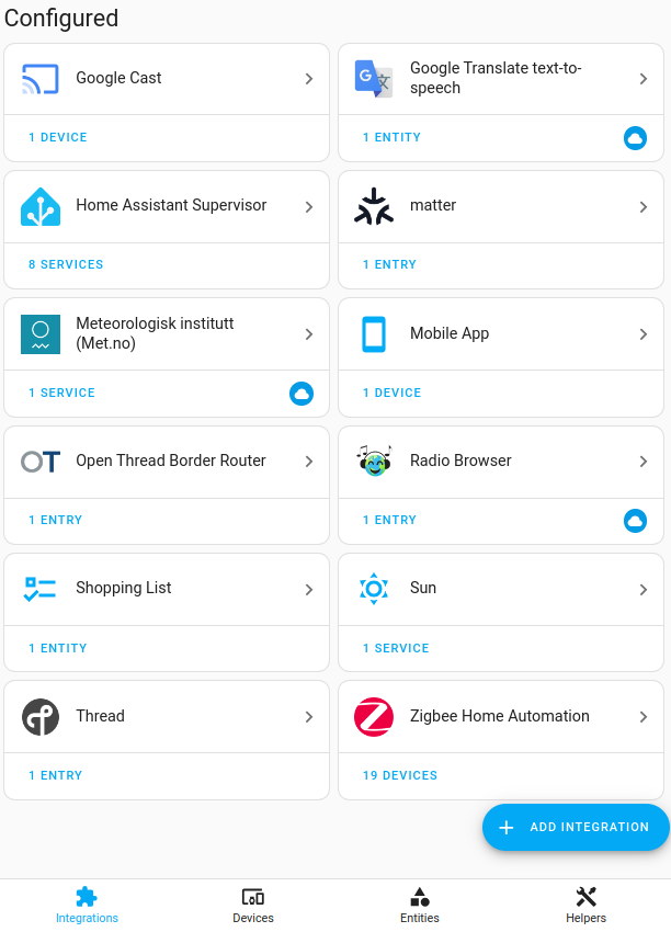

  9. Open the Integrations menu item in the Home Assistant web interface. The following integrations must be visible:
    • Open Thread Border Router
    • Thread
    • Matter Server
    HA Integrations

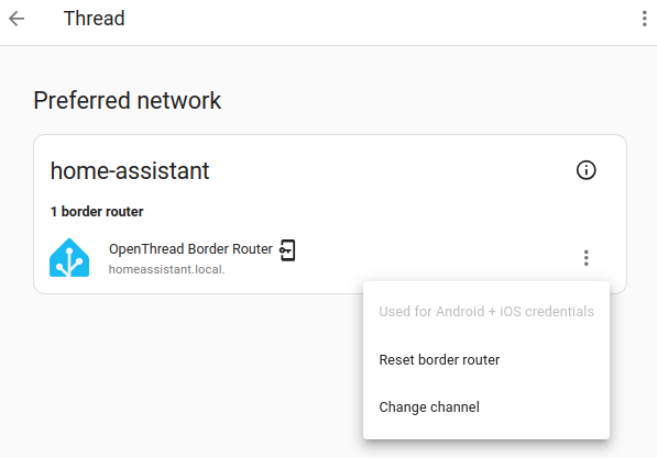

  10. Check that the Thread integration setting Used for Android + iOS credentials is enabled.
    HA Thread Integration Android und iOS

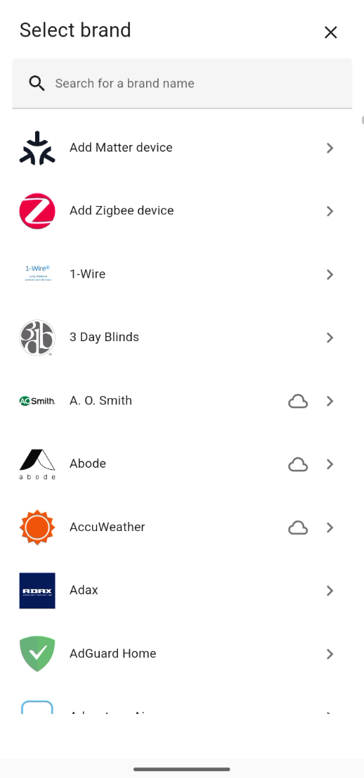

  12. Go to Add Integration and connect a new Matter Device.
    HA Smartphone App Matter Device

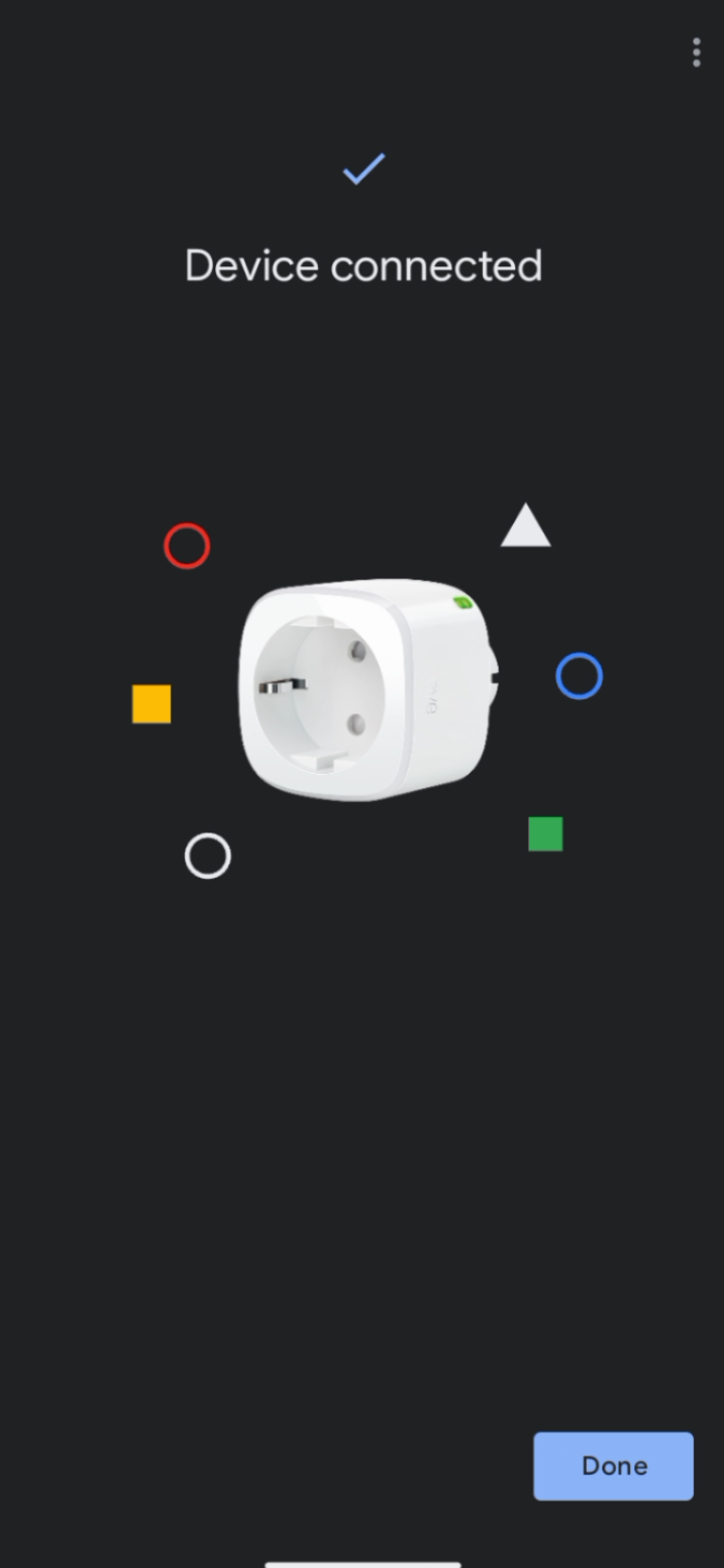

  14. After the smart plug has been successfully connected, it can now be controlled via Home Assistant.
    HA Smartphone App Matter Device found
