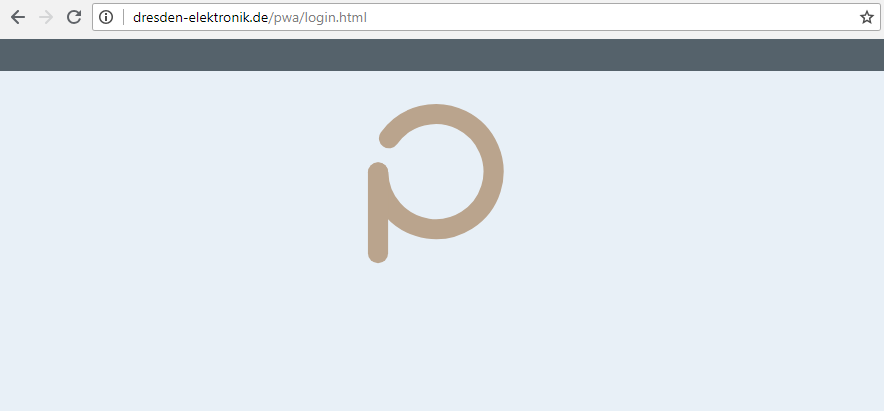

Discovery via Phoscon App
By visiting http://dresden-elektronik.de/pwa the official Phoscon App will be loaded in the browser.
discover the gateway

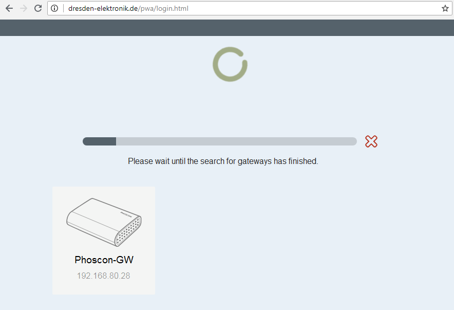

When you click the Phoscon logo the search for gateways in the local network starts. This does not require internet connection!
When gateways are found they will be listed at the page. You can connect to a gateway by selecting it.
