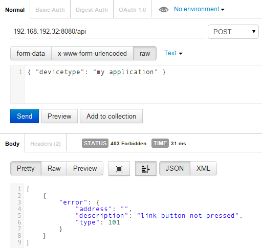

Acquire an API key
Any client that wants to access the API must provide a valid API key otherwise the access will fail.
To acquire an API key send a POST request to
/api as follows. Use the IP address and the port of your
gateway that you got during discovery.
Note The request must contain a JSON object with the
required field devicetype.
Note In some Rest clients it is mandatory to put
‘http://’ in front of the IP address of the gateway.
---> This didn’t work!
The STATUS says
403 Forbidden.
The response body provides further information about the raised error in the JSON object.

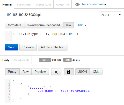

Unlock the gateway
The reason why the request failed is that the gateway was not unlocked. This mechanism is needed to prevent anybody from access to the gateway without being permitted to do so.
As described in the section Authorization unlock the gateway as follows:
- In a new browser tab open the webapp
- Click on
Menu/Settingsfrom the top menu - Click on the Unlock Gateway button
Now the gateway is unlocked for 60 seconds.
Second attempt
Within 60 seconds after unlocking the gateway, go back to the REST client and repeat the acquire API key request as before. (just click on Send again)
This time the request succeded with STATUS 200 OK.
In the response body the new API key is in the field
username, from now on this key will be used in further API
requests.

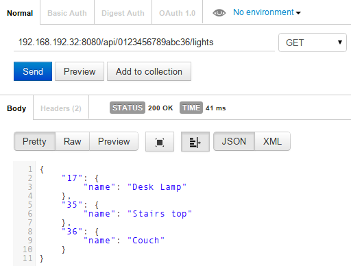

Get a list of all lights
With the API key from the last section it is now possible to access the full API.
To get a list of all available lights run a GET request
to /api/<apikey>/lights as follows.
In the response 3 lights where returned. There are serval things to note here.
- The response contains not a list like
[ ]of lights but a object{ }with key/value pairs - Each light can be accessed by its id
"17" - The light id is a key in the response object and the related value is a further object
Note Ids are strings and even if they contain numbers
never expect them to be “1”, “2”, “3”, … if the user
removes light “2” the list will become “1”, “3”.

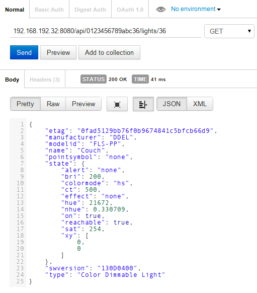

Get light details
To get the detail of a light do a GET request to
/api/<apikey>/lights/<id> as follows.

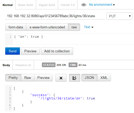

Turn light on/off
To turn a light on/off do a PUT request to
/api/<apikey>/lights/<id>/state as follows.
In the request body set the on value to true or
false to turn the light on and off.

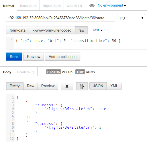

Dim with transition time
Dimming is done the same way as sending on/off by using the
bri parameter; additionally specify a transition time in
1/10 seconds.
The following example dims the light in 5 seconds down.
