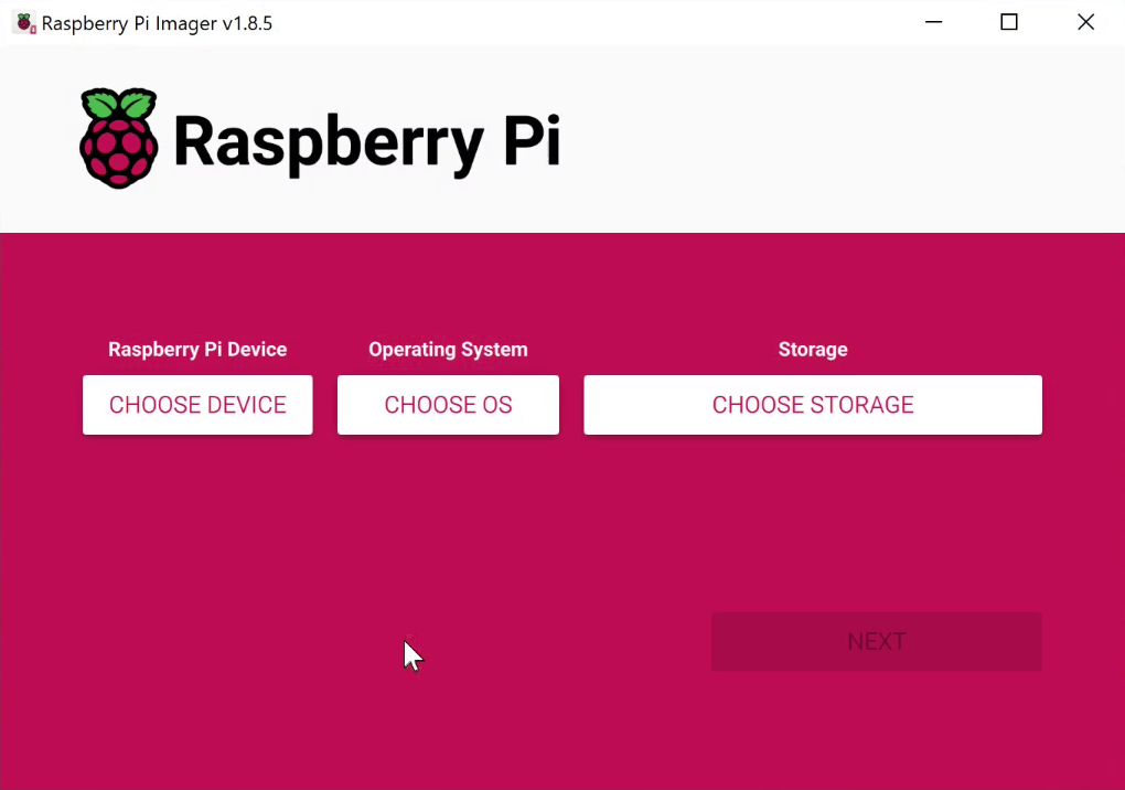

  1. Download and start the Raspberry Pi Imager on the website www.raspberrypi.com/software Raspberry Pi Imager Start Screenshot

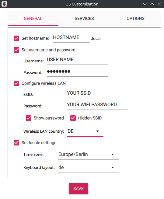

  6. Use OS Customisation: Click on Yes to adjust the settings: host name, user name, password, WLAN, time zone and keyboard layout and save with save.
    Attention: If no user name and password are assigned in this step, this must be done in the Raspberry Pi OS interface when the system is started for the first time, otherwise the operating system cannot start.
    Raspberry Pi Imager Edit Screenshot
