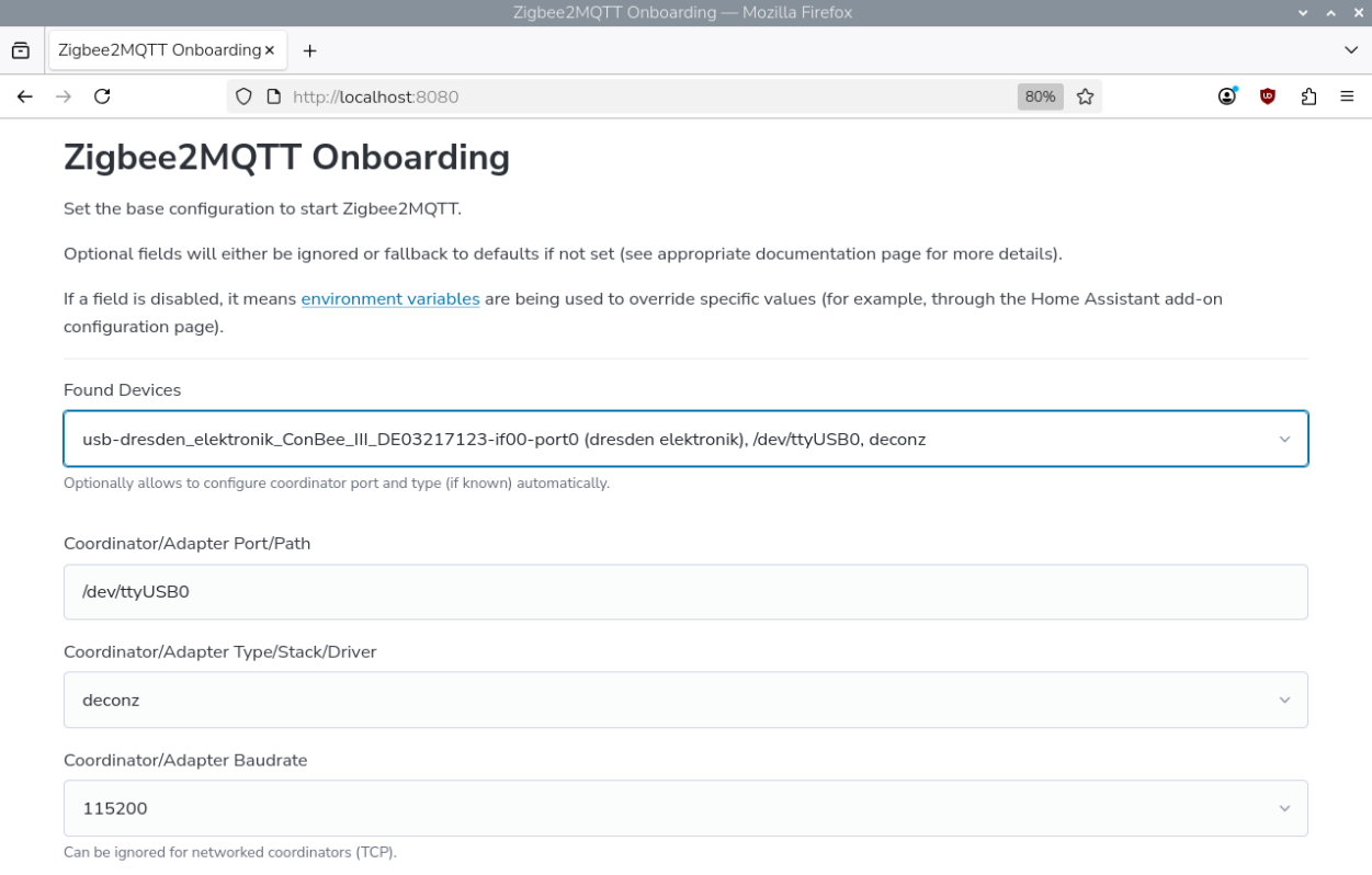

  5. Open the web browser on the Raspberry Pi and start the Zigbee2MQTT onboarding via the address http://localhost:8080
    or
    Start Zigbee2MQTT onboarding with an external web browser from a PC or laptop via the Raspberry Pi:
    Method 1: http://raspberrypi:8080
    Method 2: [Raspberry_Pi_Hostname]:8080
    Method 3: [Raspberry_Pi_IP_Address]:8080

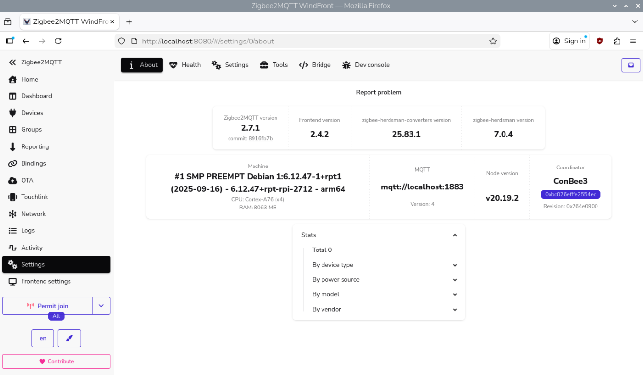

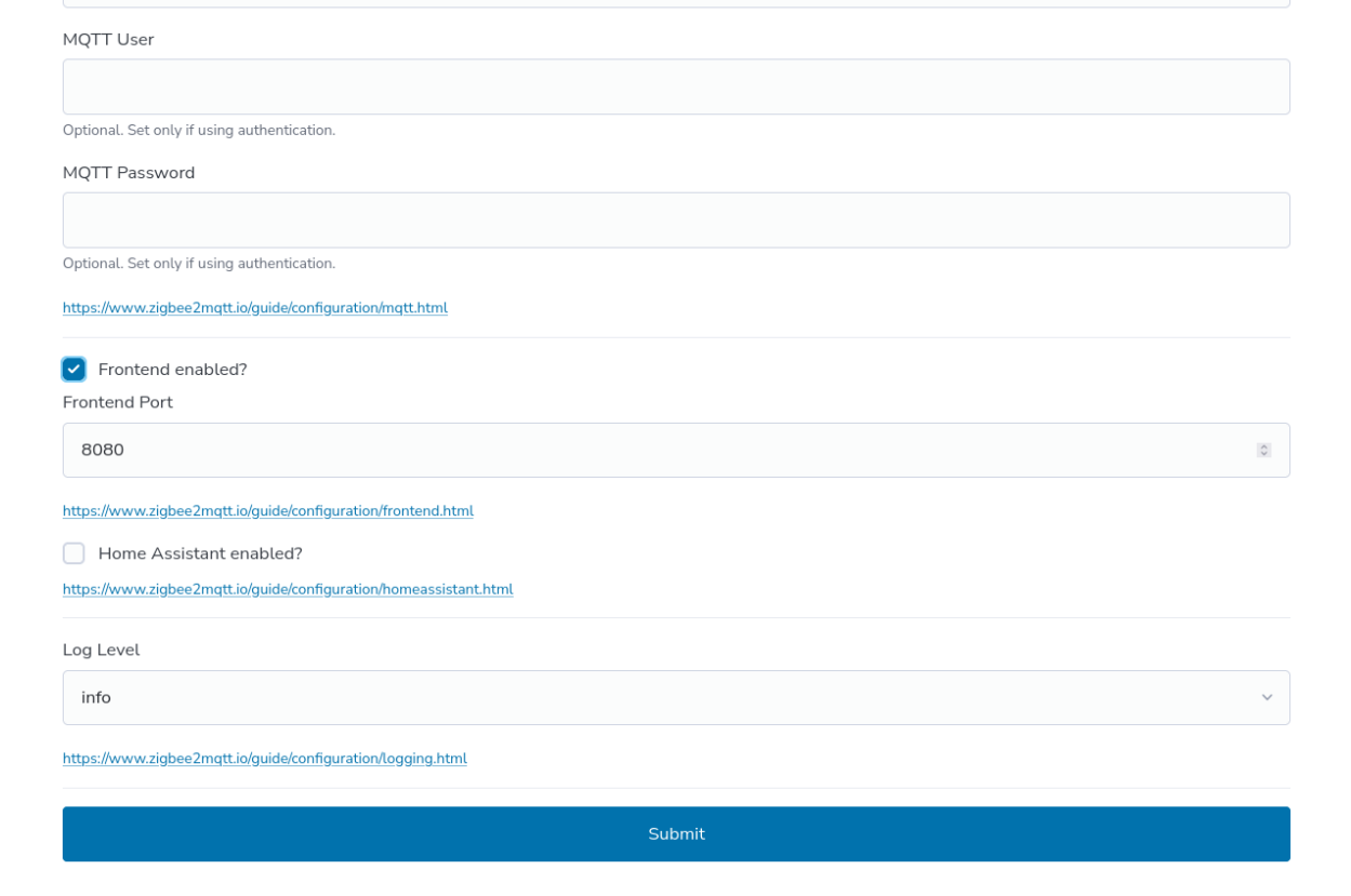

  6. Select the “ConBee III” and check that the baud rate is “115200” and the adapter “deconz” is set ConBee III Onboarding Selection Adapter
  7. Activate Zigbee2MQTT frontend and click “Submit”. Activate ConBee III Onboarding Frontend
  8. After about 30 seconds the Zigbee2MQTT frontend will be loaded Zigbee2MQTT frontend
The first Zigbee devices can now be trained via the web frontend.

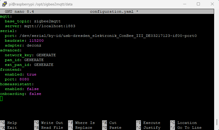

  1. Open directory for configuring Zigbee2MQTT
    cd /opt/zigbee2mqtt/data/
  2. Create configuration file configuration.yaml
    nano configuration.yaml
  3. Enter the previously determined connection port, the baud rate 115200 and the adapter deconz and save the configuration file
    Example with generic interface name ttyUSB0:
    mqtt:
         base_topic: zigbee2mqtt
         server: mqtt://localhost:1883
    serial:
         port: /dev/serial/ttyUSB0
         baudrate: 115200
         adapter: deconz
    advanced:
         log_level: info
         network_key: GENERATE
         pan_id: GENERATE
         ext_pan_id: GENERATE
    frontend:
         enabled: true
         port: 8080
    homeassistant:
         enabled: false
    onboarding: false
    Example with defined ConBee III device name: ConBee III adapter configuration
  4. Start the Zigbee2MQTT application. If configured correctly, no error messages should appear.
    pnpm start
    Zigbee2MQTT Start
