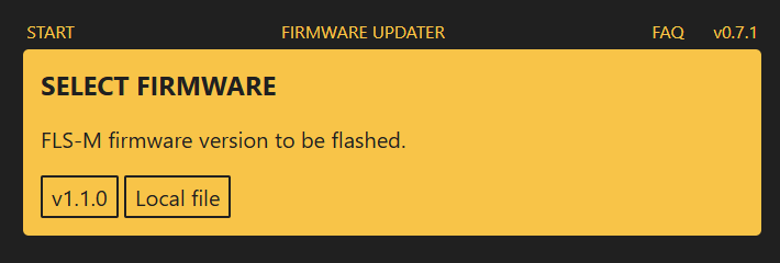

Update via USB interface directly in the web browser
Open the Online Firmware Updater
Connect the FLS-M to your PC/laptop via USB-C
Perform the update
Once the update process is complete, disconnect the USB-C cable from the FLS-M
Connect the FLS-M to the power supply or turn on the power supply
Done!

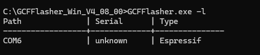

Open GCFFLasher via terminal. A COM port number must be displayed in the
Path
column and the valueEspressif
must be displayed in theType
column.

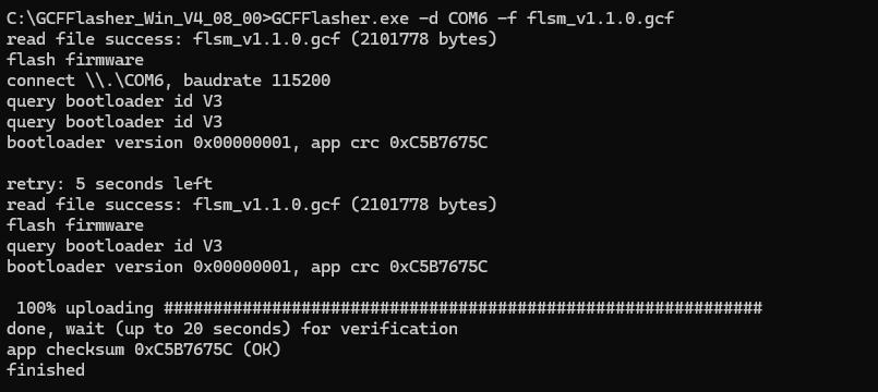

Enter the prompt for the example with COM port 6:
GCFFlasher.exe -d COM6 -f flsm_v1.1.0.gcf
